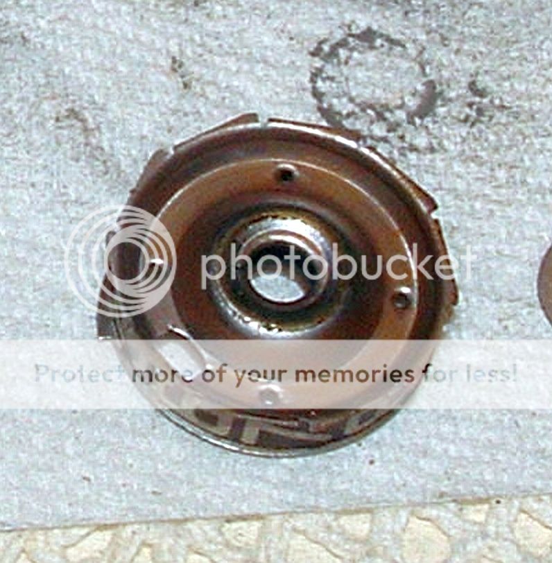

When I replaced my angle drive after my speedometer quit, I discovered that the square-shaped pin that comes out of the device the angle drives attaches to was sheared off. The part appears to be compressed wires or springs. I have searched the usual parts suppliers catalogs and do not see this part listed. Am I not seeing it? If A new one cannot be purchased can a substitute be made?

Great Pumpkin the shaft extending from the angle drive in your picture is the part in question. My part is twisted on one end. I installed the angle drive over a year ago and installed a new cabel with the new drive and the speedometer bounded. I went back to the old cabel and it worked fine for a while and quit. I used my GPS for a spedometer and put that project on hold until I replaced my U joints this week. Since I had the gearbox cover off I thought I would try again.The washer that is discussed in the product description is it the brass one that came with the angle drive kit? Does it have to be installed in special way? The way the angle drive is threaded where it attaches to the gearbox is that an adjustment feature or do I just tighten it down as far is it will go?

The short stub of a cable extending from the angle drive is repairable. On the opposite side is a flat, round plug which is peened over to hold it in place. Remove that plug, and you can slide out the gear and what remains of the cable. You can then press out the cable from the gear. The cable is pressed into a sleeve, which presses into the gear. I bought a cable kit from the local O'reilly's, cut the square end off, and soldered it into the sleeve the pressed the sleeve back into the gear. So far 500 miles on the car and cable and its still working. My problem though was that the speedometer was locked, which caused the angle drive to sheer. I had to disassemble the speedo and free up the main gear bearing which apparently seized due to corrosion from sitting for 40 years.
