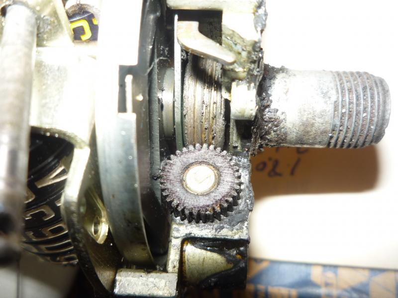

I disassembled both the speedometer and the tachometer. No issues with the tach, but the speedometer input shaft was seized and the trip odometer plastic gear has two broken teeth. So I guess I'm in the market for either a spare gear or an entire speedo I can break down for parts. If anybody has one they are willing to "part" with, please let me know.

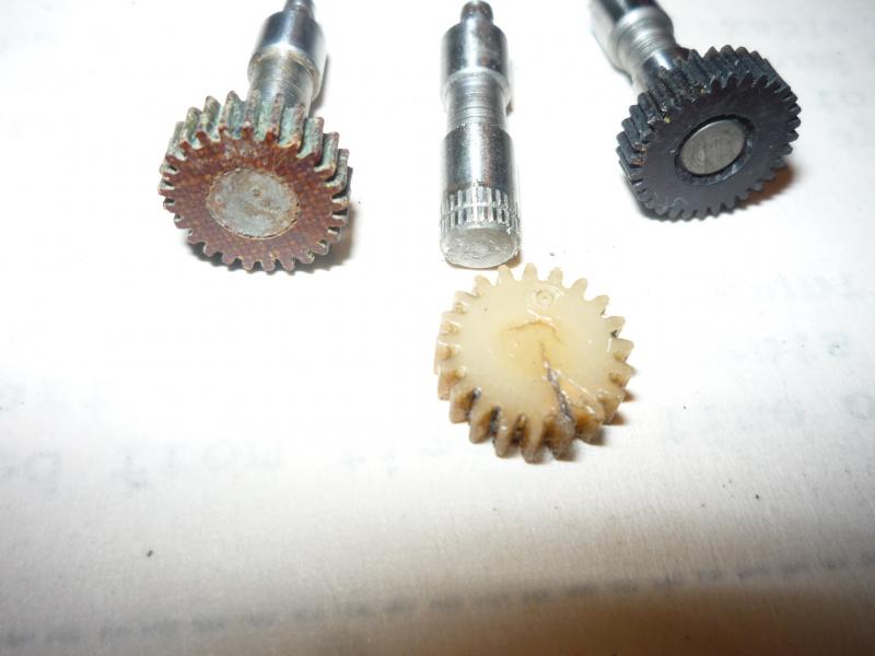

I took a picture of some wheels I have. The right one is a 32-tooth gear from a TR4A. The odo numbers were frozen from age and when I tried to test it, stripped a few teeth. (Note to self: Always fully dismantle first). I might try popping it off the shaft, reshaping the resin teeth, and replacing it in a different position so 'good' teeth can drive the pawl to advance the miles wheel.
The left is a 25-tooth wheel; not sure what it goes to (4.1 rear axle?) but the point is to count the teeth when replacing gears.
In the center is a 20-tooth plastic TR6 odo gear that cracked and stopped driving the miles wheel. I tried gluing it together but fitting the metal shaft opened the crack again.

My saga has been four failed angle drives in 20 years due to speedometer binding. Had the speedo rebuilt twice. Apparently they used or installed NOS gears which (at this age) develop a hairline crack in them. Once the gear cracks, the teeth no longer nicely mesh with the worm gear - causing binding in the speedo head - which then results in a snapped angle drive.
These are newly manufactured gears (direct injection plastic) made from Celcon which includes graphite in the material and supposedly self lubricating. Not cheap ($25) but, better than $175 to rebuild the gauge with NOS parts which will only fail (again) and blow up my angle gear (again). Not to mention angle gears cost $45.
