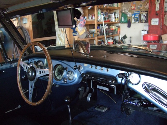

A GPS driven cable drive for speedo, Please forgive me for being a real smart alex, Why don't you just hang a GPS unit in the car. I constantly check mine to compare mph with the original speedo. And if you do use your car for shows and concours you don't upset the originality of the car. Just remove the GPS unit for the day.
By the way has anyone considered the electrical load on their original Healey electrical system using any GPS receiver. You might notice the the twin auxilary power plugs mounted to the shelf of my Healey. See pic.
Those are for the GPS and the Ipad/cell phone. Of course my car has an 85 amp alternator, with custom wiring harness and two 8-pole fuse boxes. Just saying, better check your electrics.
