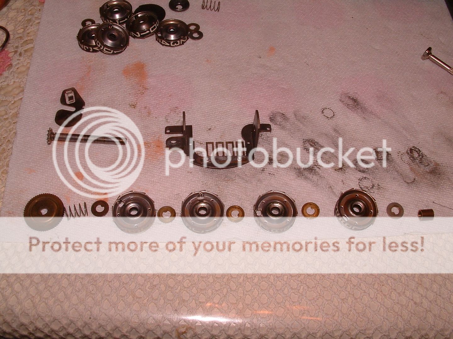

Not much else to it, besides the speedo and the drive gears inside the transmission. The speedo on my TR3 was wavering worse than that, and the problem was entirely binding within the speedo head. Took me a couple of tries, but I finally got it smoothed out until now it only wavers 1 or 2 mph.
Not sure if your Sprite would be the same, but in the TR speedos the odometer and trip meter each have a dog moved by an eccentric shaft that in turn moves a gear one tooth at a time. The odo & trip mechanisms were so tight that every time a dog tried to move a gear, the speedo cable would wind up (causing a low reading), then once the gear was done moving the cable would unwind and cause a high reading. I had to completely disassemble the trip & odo to polish up all of the friction surfaces.
