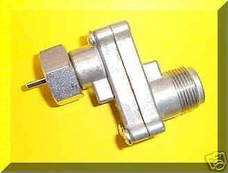

I have a ratio adapter on my TR6. I needed it after installing my 5-speed Supra transmission. You can get them at most speedometer shops or on-line. I think I paid around $100 a few years ago.
They look like this:
Here's a place I just found on the net:https://speedometercablesusa.com/gear_box_adapters.html
