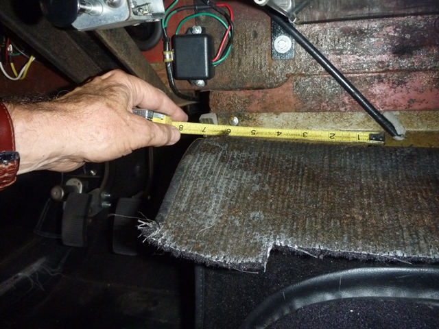

The guy who answers the phone, Peter Bayer can answer your questions. He has an info sheet on how to set these up. You may just take his sheet to a local speedo shop and have them put the Toyota end on it. I would join the club and have one of the local people look over your setup. Here's my routing - about 7" from the left.
I don't think the upper right is going to work. The cable goes forward on the right side of the tranny then loops gracefully to the left in front of the bell housing. Your opening through the first "extension panel" should be at this point. Many cars have grommets there. My extension panel is homemade so I didn't have the grommet and cut a slot padded with foam tape.
