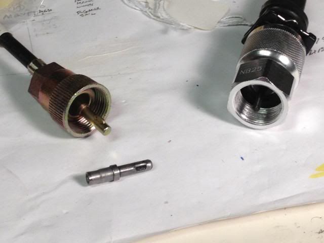

The only problem is that the rotating core of the GM sender is a 3mm square-section bit and the rotating end of the Nissan cable is ~4mm round with a tab swaged into it to fit into a slot in the receptacle.

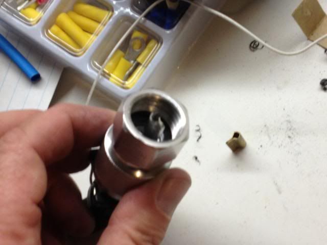

Even Palo Alto Speedometer wasn't sure what to do. I wound up making a mandrill to duplicate the core of the GM sender by filing a 3mm nail into a square section and taking a 3/4" long section of 1/4" brass tubing and squeezing it around the mandrill with pliers to get a square section with a tab. It fit both the sender and the trans and engaged the slot in the trans receptacle.
I later made one out of stainless steel and stuck the works in the car. In the picture, the brass one is on the right, the stainless one is installed in the sending unit.
