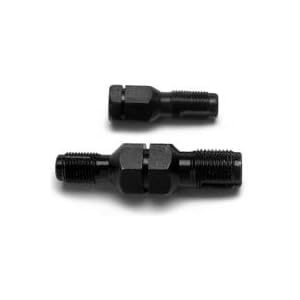

Now, about spark plugs. If you do decide to go with the longer plugs, be sure to buy a "spark plug Thread Chaser". The threads at the bottom of the hole will have all kinds of deposits on the and you need to remove those before putting in the new longer spark plugs.

Thanks a lot for the responses. I'm going to grab a chaser and run that through first. I wish the spark plugs were the hardest question I will be asking, but I'm going to be running through the entire car and trying to bring it back to life, so many more questions to come. Thanks again!
Good practice IMO, even if you aren't changing plug reach. Also a good idea to smear some grease in the flutes, to try and catch some of the gunk from the threads, rather than letting it fall into the cylinder where it just might get caught and scratch a wall.
