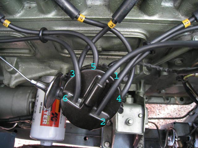

Hi Robert,
I think the point of confusion (at least for me) is what you are starting from. Do you have wires already mounted in the dizzy cap, or are you installing new wires in a new cap and don't have an old one for reference. A recent thread talked about the 20-til-2 rule. With the #1 cylinder on TDC of the power stroke, the rotor should be pointed to the 2 o'clock position. So your #1 plug wire would go to that point in the cap. Then you follow the firing order around the cap in a counter clockwise rotation. I've added the plug-to-cap map onto Roger's photo below. I don't really know what you're asking when you say "<span style="font-weight: bold">any particular wire to start with on the distributer or is it a matter of starting with the first one that reaches</span>" but I hope I've covered it accidentally.

Now that is just what he needed and he will not go wrong---Keoke-- :thumbsup:
