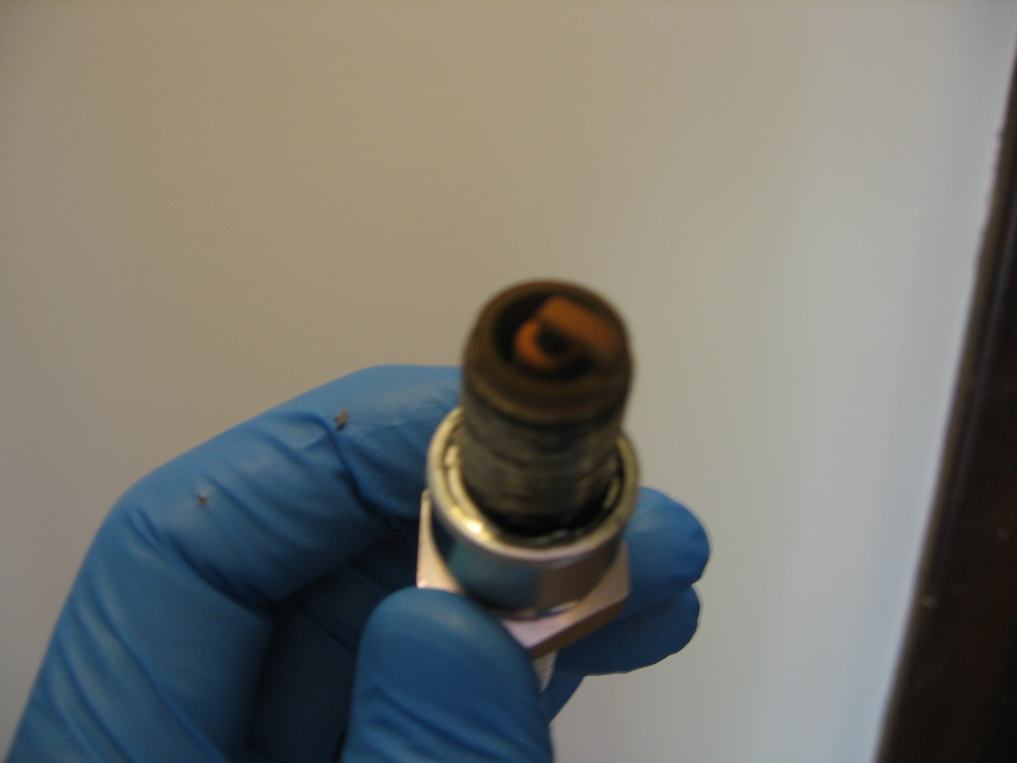

My car needed some tune up work.
I replace the points and condenser, spark plugs, the needle and seat, and adjusted the floats height.
A new distributor cap and rotor are on the way from Toms Import Sales (Moss dealer).
The car runs great.
Attached is a picture of the new spark plugs, after a 30 minute drive. They are all the same color, leaning towards the red/rust color.
The compression is around 155 psi (dry) throughout.
The floats are still in need of fine toning, as I am getting fuel out of the manifold drains.
Thanks.
Ron
Hi Ron, the picture is a bit blurry but if that represents 20 miles or so, it is way too rich - fresh plugs after 20 miles should still look like brand new plugs. If they are all the same color, that indicates both carbs are set too rich. I still have no guess as to what the reddish color means.

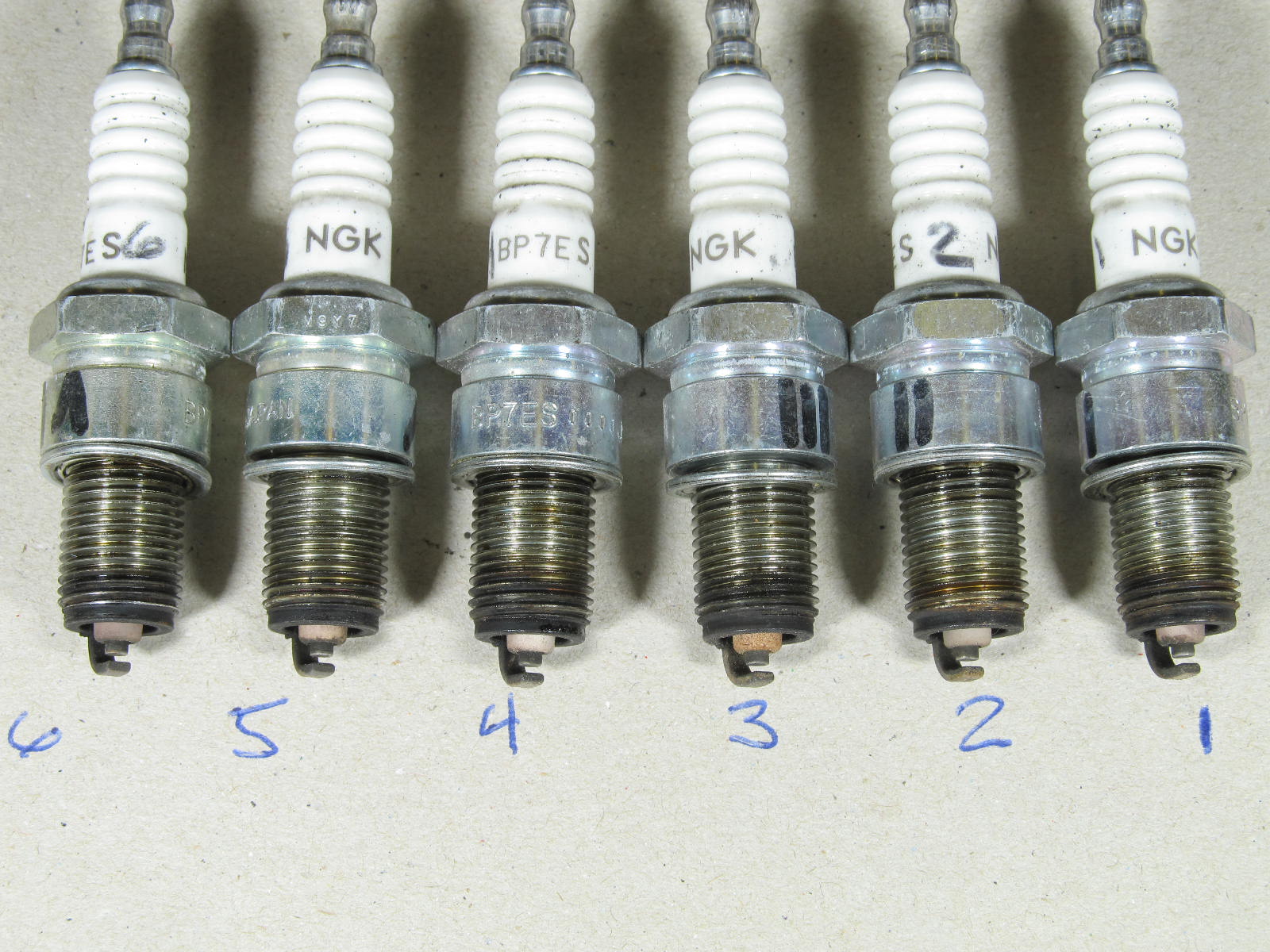

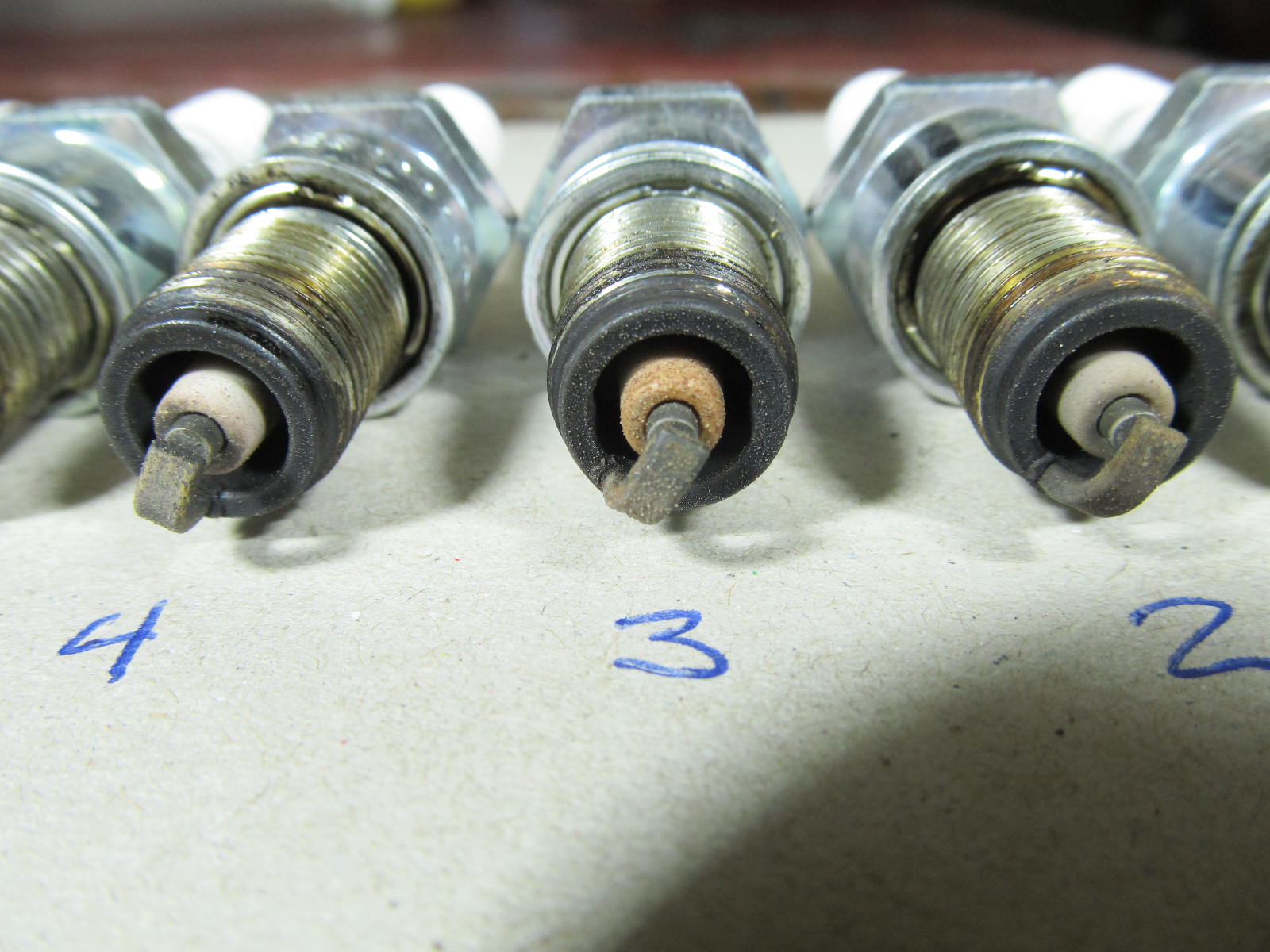

Last year I had one plug out of the six that showed some reddish color. Plug #3 in the pictures below - this was at about 6500 miles. Don't recognize the color as any particular warning so I'm still driving....
I am not a believer in gross jets and prefer stock viton-tipped needles. Your car should have a pair of HD6 carbs and the float valves should be set using a 7/16" test bar as shown in the manual - no fine tuning required. You can easily check that they are shutting off correctly by removing the dashpots and vacuum pistons and looking at the tops of the jets. With the pump on, the fuel should be just below the tops of the jets and none should be flowing out of the jet. If there is fuel flowing out of the top of the jet the needle valve is not shutting off correctly. Make sure this is correct before you try another test drive. Don't worry about whether the pump is ticking or not, they sometimes tick even when the flow is shut off due to internal.
Once you are sure the float needles are functioning correctly, you can proceed to adjust the carbs as outlined in your shop manual.

I'm dense ... but what were the plug colors *before* you did that 500 mile trip?
Also, those red/orange tips look like extreme heat.
