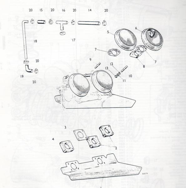

Right, if it is the spacer I think it is, there should be two per carb placed each side of the heat shield, I am not aware of a spacer between the carb and the filter.
They are called up in the SC Parts manual, but I have not checked to see if they are priced - they list all parts but some times not all are priced as they have not sourced a manufacturer yet. And yes - they are a form of plastic but not sure what - obviously resistant to heat.

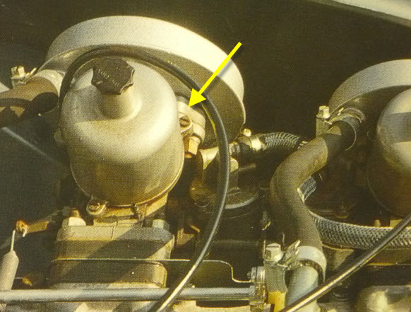

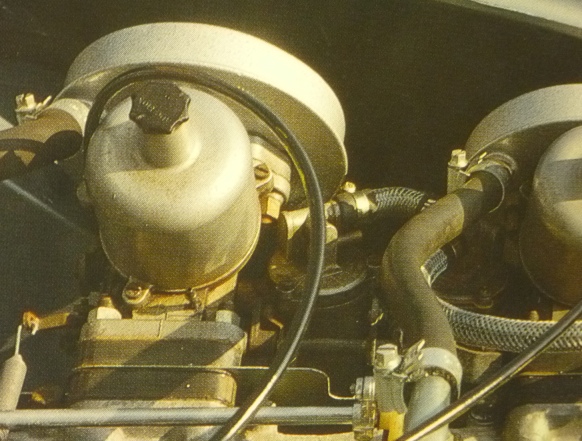

The rear spacer provides clearance for the air filter to the nearby frame member in the BJ7. There is only one spacer, and it's on the rear carburator. The original is aluminum and about 0.5 inch thick. I've never seen one sold as new.
From Clausager, pg. 58.

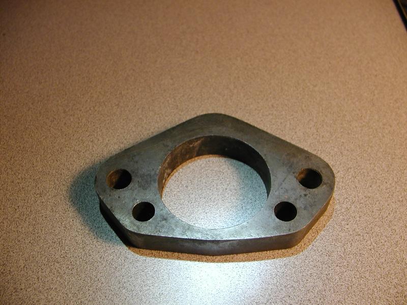

Did you ever find one? I sorting some parts and came across this:
It is aluminum, 1/2" thick with a hole size of 1-5/8" diameter. Is it the right part?
