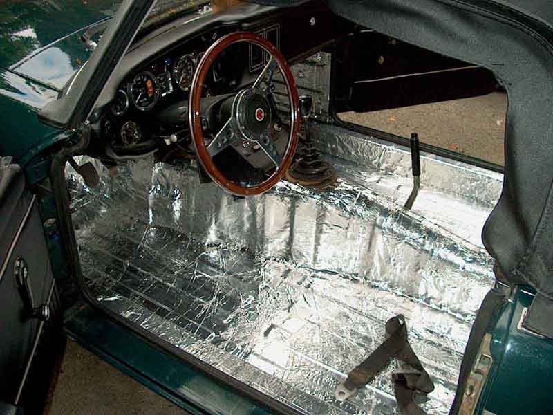

You are right in order to lower road noise you must install sound deadening materials. All new cars have it all over the place and the first problems with MG (and others) is that at a point in time they were rebuilts with new floors and there is no insulation anymore.

I insulated my car completely and the difference is really big (specially since I am running a modified engine with headers).
I have removed the whole interior and installed a product from a company called B-Quiet all over the floors, back, door skins and so on.
I took some pictures that I will try to find back.

Thanks for the web site regarding b-quiet. I think that's the way I'll go. They seem to have pretty good products. Thanks again to all of you for the feedback.
As promised here is the picture with the B-Quite material installed
