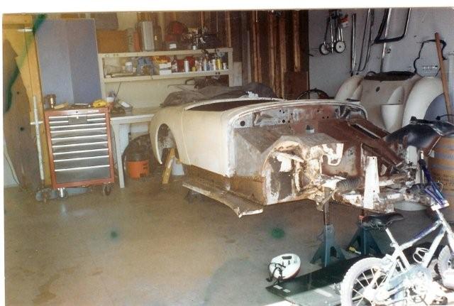

Sometimes it's best not to look...
It's amazing how I have the same pics but sadly mine was way too rusty in the boot, floors and just about everywher you could think.
