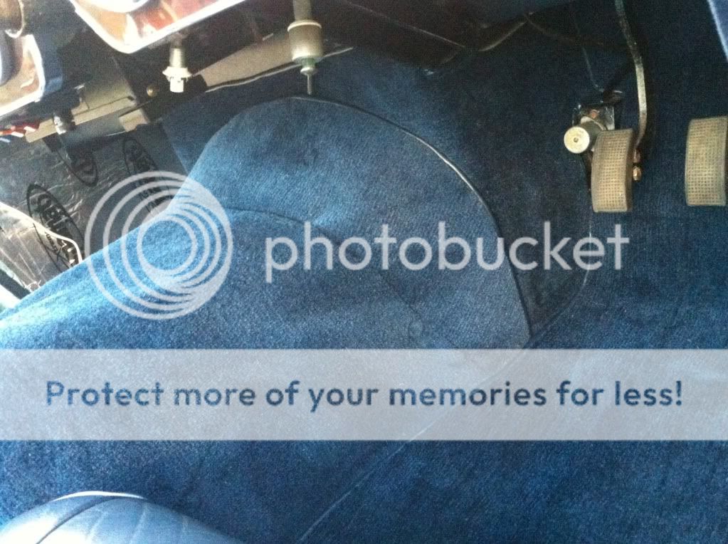

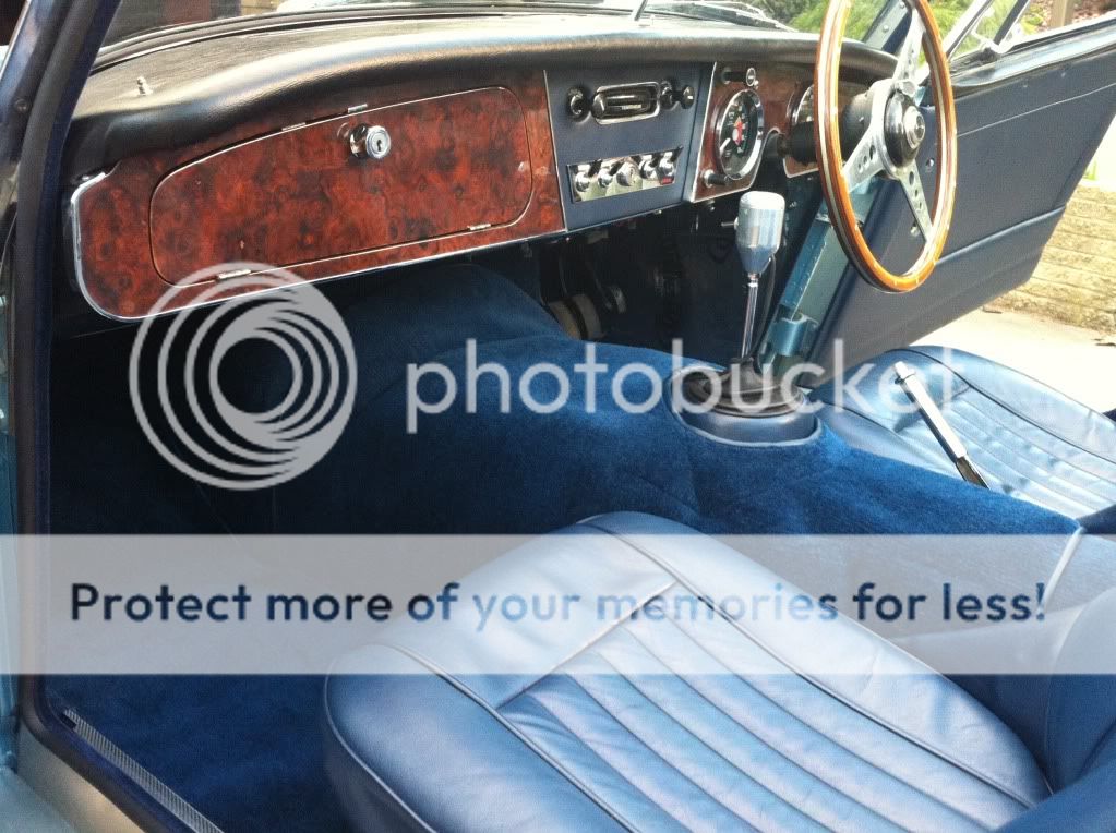

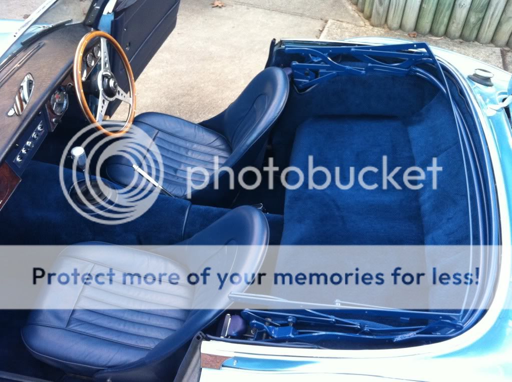

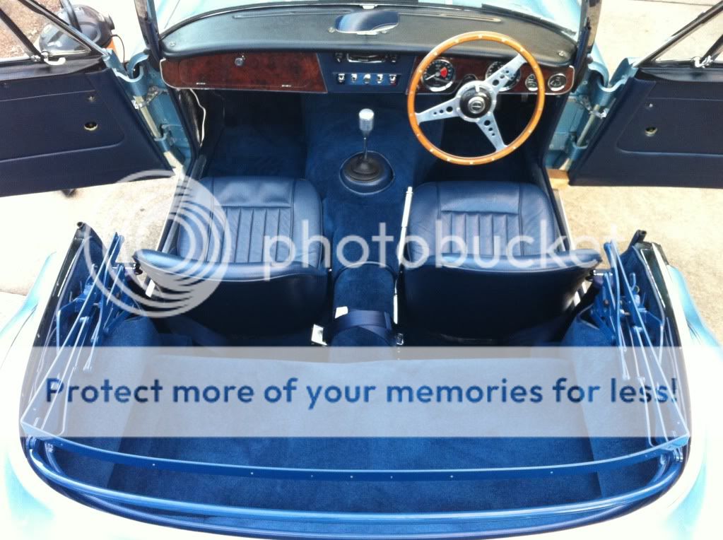

Also the carpet snaps are all in except for the ones I'll fit to the front edge of the rear section - but I want to get a little soft foam to fill the void under the carpet left by the uneven surface around the seat pan cut-outs.

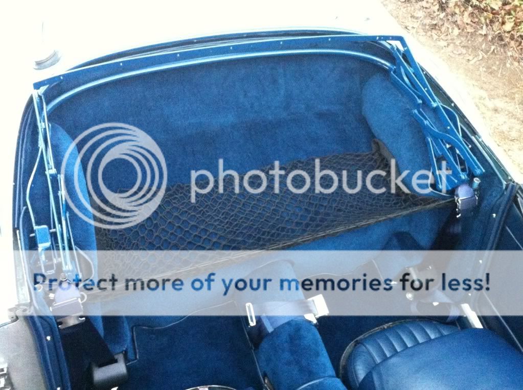

And I'm playing about with the placement of a cargo net. At the moment i've looped the ends over the tubes the tonneau bow seat in.
