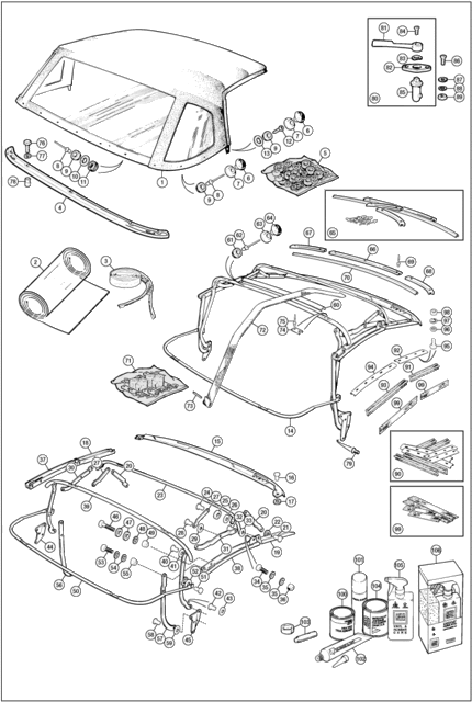

What part are you talking about?
Part number 4 on this diagram.
Andy: thanks ... maybe also the flex in the bar makes attaching the soft top slightly easier: it will "give" a little when pulled forward?
The purpose of the retaining bar is to be able to stretch the convertible top and keep it taut. When installing a new top, the canvas is first glued to this bar and the slack taken up on the front bar. Bypassing the use of the bar is a recipe for a loose top that will never stay affixed to the body in a satisfactory way. It is possible to correct this by purchasing a new bar (they are readily available) and place the new snaps in with the male portion exposed to the outside for use in holding the convertible top cover in place. The snaps are drilled through the retainer bar. You may have some unwanted holes in the body from your incorrect snaps but these will be covered.
