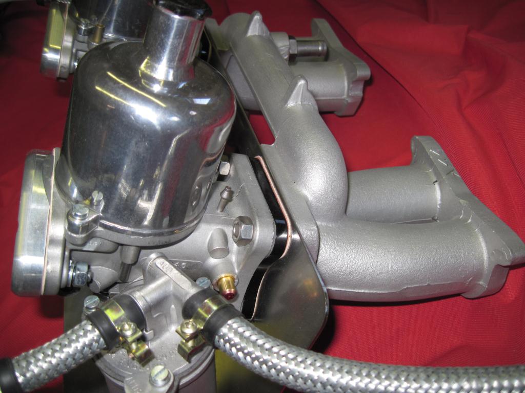

Thanks Paul. They are Smiths hoses that I purchased from minimania.com. The clamps are standard fuel-injection clamps that I purchased by the box from somewhere. The aluminum pieces bolted to the carbs are k&n stub stacks that go inside the air filters and act as a velocity stack. Heat shield is from ARE.
