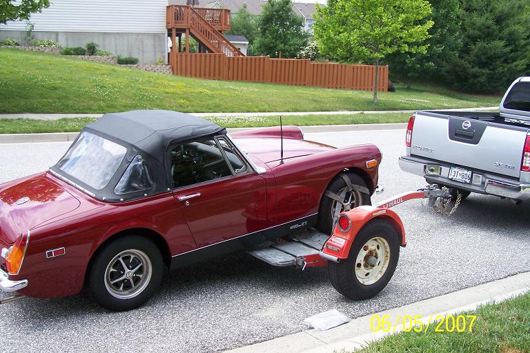

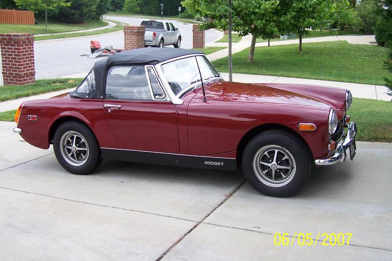

Well, I decided the time had come to pass my Midget on to the next generation. I sold it today to a fellow club member who has a 15 year old son; they will be finishing it up as a father-and-son project. When his boy turns 16 and gets his license he should have a really cool set of wheels.
Here is a final portrait while under my care, and the good-bye photo as he headed to his next home.

Looks finished to me. Maybe no engine so it needed towed.

BTW, that is a one beautiful car. I would be dead if I had that car at 16: either from a horrible wreck or a case of VD.

No, it had a strong little engine that just needed to have the Weber DGV set up properly. The main reason he towed it is that the brakes need some attention and I had not gotten around to that part. I spent most of my time with this car addressing a lot of DPO wiring issues and getting the bodywork in shape. Brakes were next on my to-do list but when the oppotunity to give it a good home and get a youngster engaged in the hobby presented itself. The remaining work is well within the reach of a young person who can read a shop manual and will give him a rewarding experience without too much pain and suffering.
