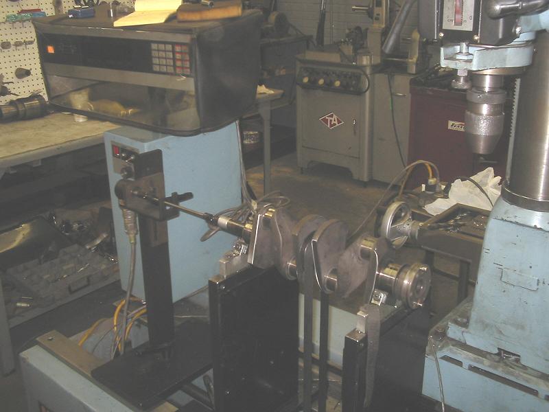

A wedged 1275 crnak is how you ligten a 1275, by taking off the extra weight it has around the journals (which is where you want to remove weight on crank, some cranks need very little removed from this area, a 1275, and a MGB flat side cranks have alot of material to remove form this area) The term "wedged" comes form the ending shape of the counter throws when you done lightening. Basic'y wedging is done on a mill with the crnak in v blocks, the crnak is rotated to angle in the v block in which the mass or material at the journal is removed, but by the timew you get to the end of the counter throw, the cut is nothing more than a skim cut, it leaves the counter thorw looking like the shape of a piece of pie or a wedge, hence the name. Not amny folks do this anymore, there's alot to this job, balancing after the wedge job is pretty intense as well. I've been wedging crank for a while now, I guess I've probaby done 50 or more. Here's a look at a wedged 1275 crank that I did in the crank balancer.

Thanks for the reply and excellent explaination of wedging.

Yeah, wedging the crank is going the final step, it lighten the 1275 crankshaft about 2 or so pounds, which doesn't net you anymore horsepower just gets you to what you've got a little quicker.
