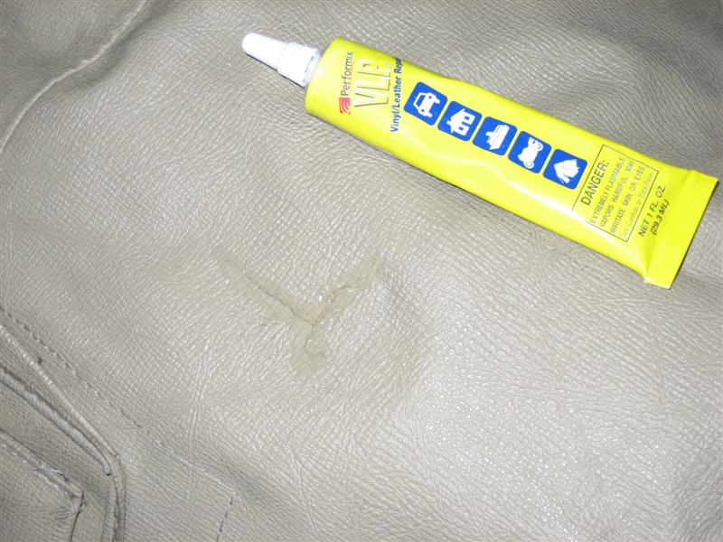

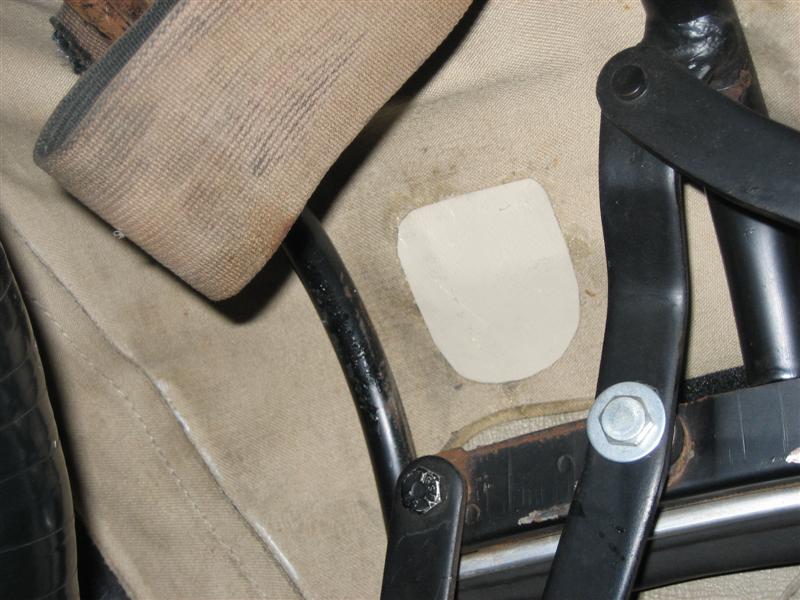

We purchased our TR6 9 years ago and the top had tears on both sides because of improper folding when it was lowered. A good friend was in the upholstery business for many years and recommended this. A product named "VIP". All these years and nearly 60,000 miles later and it still looks as good as the day the repair was done.

Thanks. I'll check out the Home Depot in Norwalk. Crowded place for sure. Tear was caused by my just flipping the top down without folding it properly. Critical spot - right on top of the bow near the rear window.
This won't make a pretty repair, but it has always held up for me when I was a poor college student. I would stitch up the tear with thick thread. Nothing fancy, just a big whip stitch. Then smear RTV (I had a black top) over the sewn-up cut.
I have used VLP and similar vinyl glues to repair tears in many vinyl parts... but not a top.
I agree with those above who show a patch applied to the inside applied with VLP. After the VLP has dried I have used a sewing awl to stitch the patch. Where moisture has been a concern I have smeared a thin film of VLP over the thread to waterproof the area.
When it was time for a new top, I saved the old one and use it for more-invisible patches. VLP looks like the right stuff.
