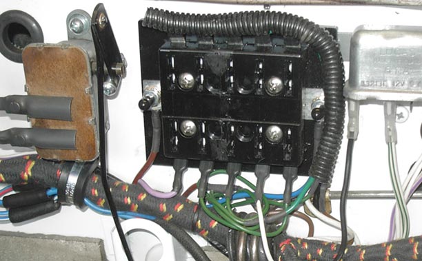

Hey Patrick,
Victoria British may still carry a 12 circuit fuse block for the Healey. I'm not sure of the dimensions though. It also incorperates a flasher relay. Walking around a junkyard would probably get you one also. Years ago, I made my own from 2 6 circuit blocks from a chain autoparts store. Cut and glued the two together to make 4 always hot and 6 switched circuits. Here's a photo.

Fuse blocks are readily available at boating parts stores. For those using an inline fuse, where exactly are you locating it? Anywhere in the wire leading to the solenoid?
