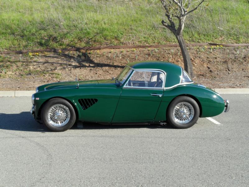

When I replaced my Longbridge soft top, I put a towel in the rear window when I folded it to keep it from scratching. Once it was in place, I never put it up again. I use this instead:
It's easier.
Yes, a BT7 hardtop will fit a BN4.
