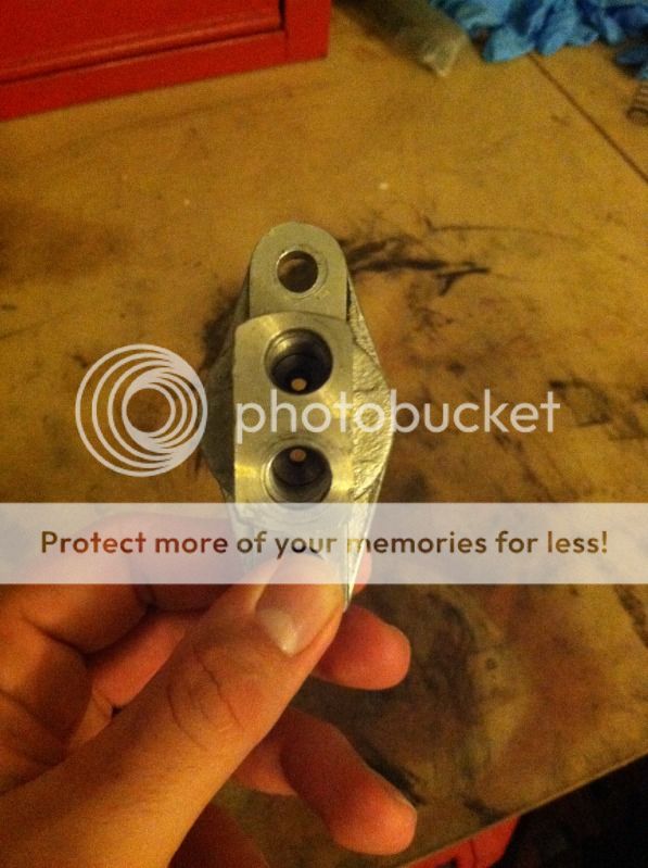

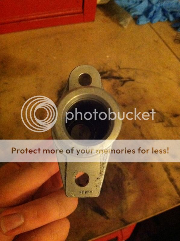

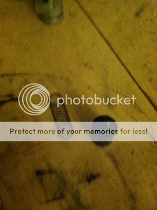

Sorry about that it is a 1959 TR3A. The slave cylinder is the Girling style. Please see the photos below.
The internal spring is used on later cars with the "self adjusting" clutch, so commonly supplied with replacement cylinders. Some of the rebuild kits used to include it as well but I don't know of any that still do.
However, the TR2-4 use an external return spring that is supposed to pull the piston to the bottom of the bore, so the internal spring is not needed and should be removed if supplied.
CJD said:
Is there something wrong with the spring in the pic?
John
Thats a good question. Im not sure how much tension that spring is supposed to produce, but currently it is very little. If that is how it is supposed to be I will leave it out, and put it back together. I have currently ordered a new exterior spring and anchor plate.
I can't remember if I rebuilt mine with a spring or not...but I totally see what Randall is talking about. The piston is held all the way in by the external spring, and pressure pushes it out, so a spring in the bore is completely redundant.
So, I don't think it will matter whether you use one or not, so long as it cannot overpower the external spring!
