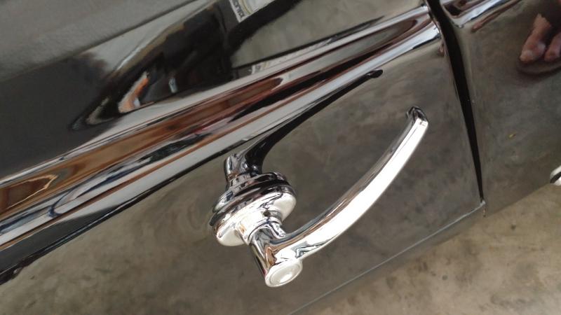

all five locks on my car needed a different key:
doors: different one each

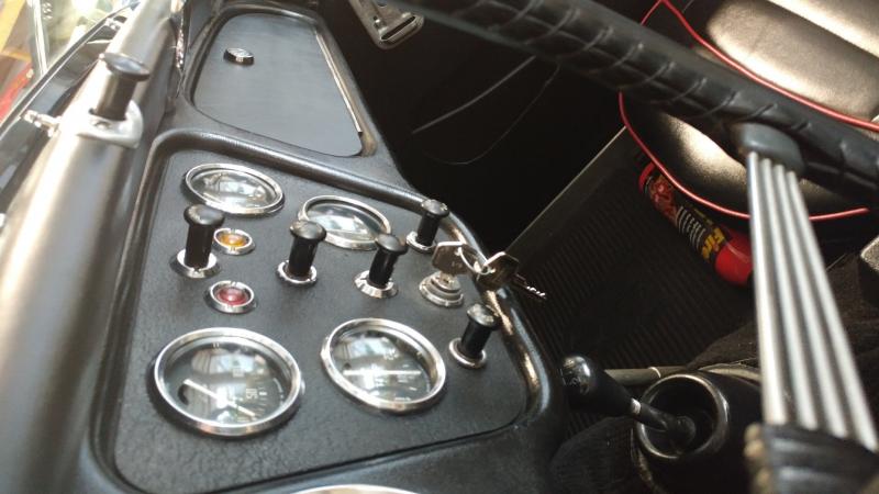

ignition
When I was tightening down a wobbly door handle, I broke a stud.
That got the ball rolling. started looking closely at all the hardware and didn't like the pitting & rather dull chrome.

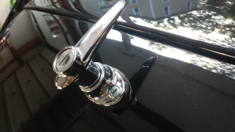

Moss offers a set that are all keyed the same. ($175.00). That was the catalyst.
the set consist of two door handles, trunk latch, glovebox latch & ignition switch barrel.
All good quality, fit easily and chromed very nicely. Also the key actually worked.
(which I was thankful for as I neglected to try each lock before hand.)

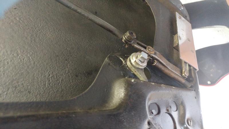

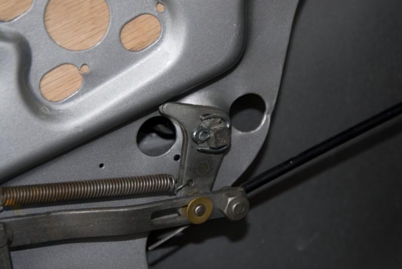

The spring clip that retains the internal door latch mechanism was another issue.
one old one was missing and the other was in poor condition.
A couple of good solutions were offered by John (CJD):
drill thru the shaft & use a cotter pin.
and Randall (TR3driver): use a split lock washer of the correct size.

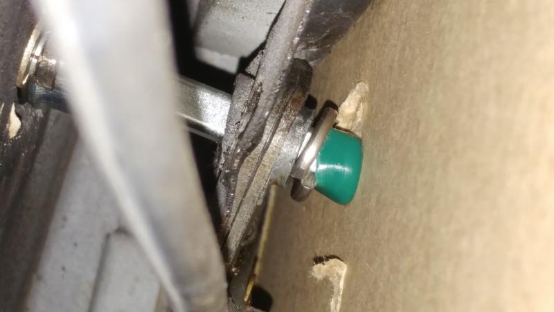

I used the lockwasher as I happened to have just the thing in SS.
(that doesn't happen very often).
to finish it up, I put a rubberized bolt cover over the end of the shaft to minimize wear on the inner door panel.

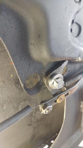

The good thing about a little job like this is it opens the opportunity to inspect/correct other issues. So once I took the door panels off I wirebrushed, cleaned and repainted the inner doors.
(Johns pic of his cotter pin solution was a motivator here, as his inner door looked brand new)
