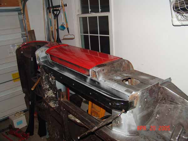

I thought I would show you guys what I've been up too. This winter my plan was to strip my car and get it painted. I knew the outer rockers had been replaced, but what I didn't know what that the inner sills had a bodged repair job and were rusting inside out. So anyway. I'm doing a complete sill replacement as well as replacing both floor pans. I'm teaching myself to weld at the same time. I've gotten both floor plans removed as well as having the right sill cut out. Just this week, I've aligned and replaced the right inner sill and last night welded in the new castle rail Here's what it looks like. (see attachment)

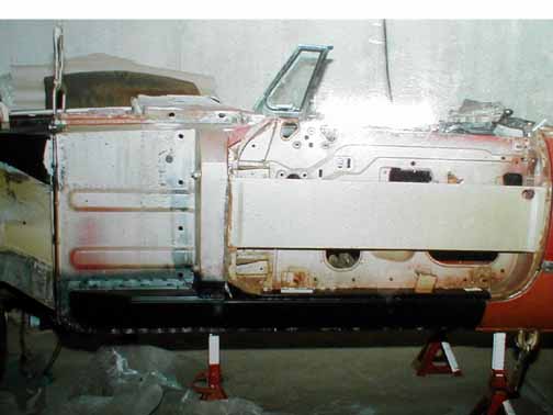

Looks good. Welcome to the club (see attachments)! Be prepared to take endless hours to get your door gaps straight.

Scott,
I had to do a double take on your photo! I assume your door has the outer skin removed! But yes, I've keep the door gap and other measurements consistant, I'm sure realigining it will a bear. And yes, I have lovely speaker holes in the bulk head, I will weld them up shortly.

The best advice I can give, it to get a MIG and start making sparks! I bought a few books, talked to guys and got a general idea of what I was doing, but welding is something that just takes alot a practice. My seams have gotten better, but in general they are ugly. So I've also gotten real good with the angle grinder! lol!

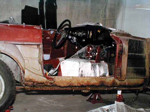

It's amazing how crispy the inner gets, while the outer looks fine. Mine looked reasonable from the outside, but this is what lurked underneath...
