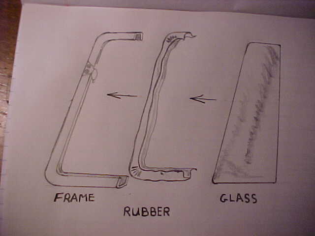

Robert, perhaps this will help, - the rubber starts out as a long flat strip that goes around both sides of the glass sides, top, and bottom, i used a medium size rubber mallet to persuade it.

Robert_Ellison said:
On one window I only wrapped it on the outside and bottom as that was the only way it seemed to fit. Do you think it matters if it isn't wrapped on the inside as well if it is tight in the frame and sealed on the exterior?
Robert
yes, if you dont wrap both sides your sure to experience a rather severe shrieking whistle when approaching speeds in excess of 193 m.p.h. /bcforum/images/%%GRAEMLIN_URL%%/jester.gif
Nice drawing Anthony. I like that you went the extra mile with the shading. /bcforum/images/%%GRAEMLIN_URL%%/thumbsup.gif

gregw, just a quick sketch but thanks, wish i could find the disk i have all them pictures on, guess its time to break down my office. /bcforum/images/%%GRAEMLIN_URL%%/savewave.gif
