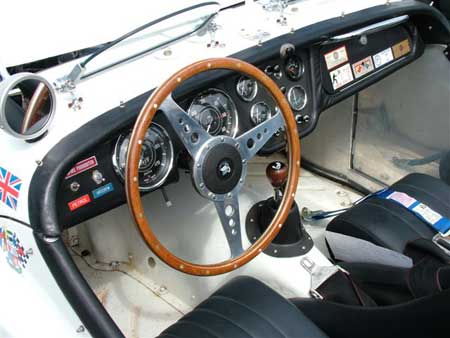

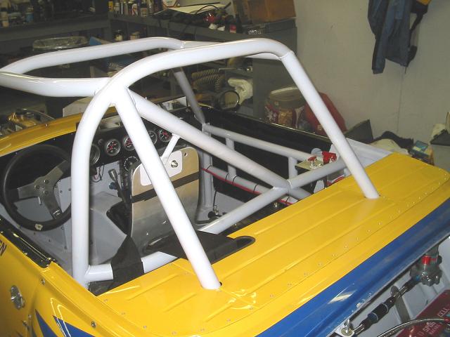

Michael, I use .030" and .050" for these applications most of the time. Here's one of the Midgets I built.

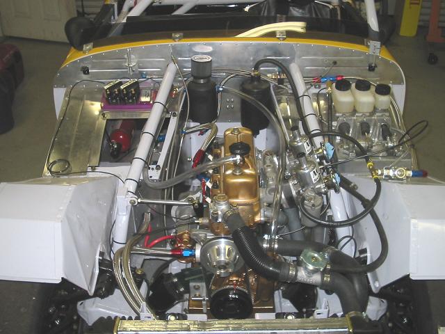

Michael, for interior panels I used .025 2024-T3 alloy aircraft aluminum sheet from Charlie Vogelsong's Dillsburg Aeroplane Works in Pennsylvania. The sheets are Alclad, which means they have a thin coating of pure aluminum. This can be polished, like I did. He will sell a partial sheet, but there is a shearing charge.
Probably aircraft aluminum is overkill, but I'm just an aviation guy through and through and I can't help it. We used Dillsburg all the time at work and had no problems as long as our Accounts Payable department paid the bill!
