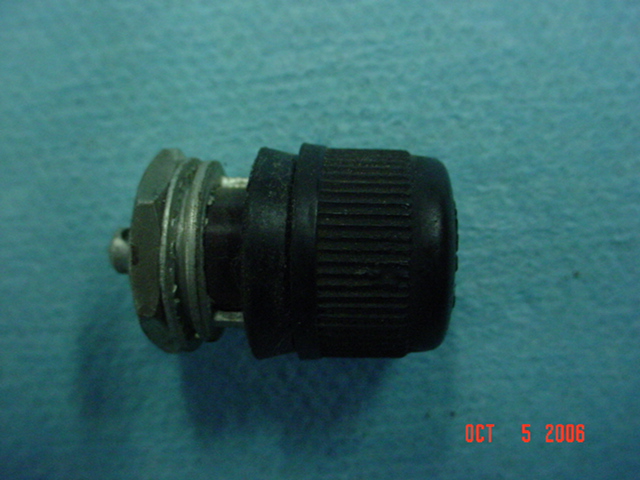

Aircraft, directed external lighting, post lights. Years ago I used these on an AH , really make the gages visible with no glare. Well shielded & directed. At the time, they were mil surplus for a few cents. I also got them from my employer at Lockheed. You can see the modern equivalent here:
https://www.aircraftspruce.com/menus/el/instrumentlighting.html
https://www.aircraftspruce.com/catalog/elpages/instrpostlite.php
Might still be able to find them surplus. They were incandescent at the time & not polarity sensitive. I don't want to ruin the clean original look of my present BN2 dash, but they really aren't too obtrusive. The old gages can be viewed much better with outside the gage external light such as this. Sort of like mini-spots.
Here is a pic of a very old style that I still have left over.

ausmhly, i used the "post" lights in the past as suggested by dave, they worked very well,on my bj7 i removed the colored plastic "defusers" from the outer ring on the guages and replaced it with a clear plactic just to keep dust from getting into the guage it allows what otherwise is low light to shine on the guage without obstruction giving much brighter lighting. /ubbthreads/images/graemlins/yesnod.gif
