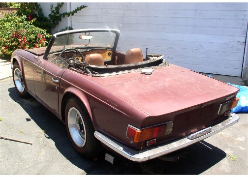

Picture attached - see, told you she wasn't a looker. <grin>
This is what 15 years of being in a back yard in Pomona CA looks like.
Driver door needs adjustment, not a frame issue (I hope).

But she's a driver, and that's what counts!

Thats not so bad! Besides, I think you can just buff it out! /ubbthreads/images/graemlins/jester.gif

Get some Mother's polish and wax, then a little elbow grease... It'll look better than many do!

Looks great! You'd be amazed what a little wax and polish will do.

Progress is the key; that feeling of bring a car back to life can't be beat. Also, if it looks that good to start with you will, no doubt, get that beauty to shine.

Actually, that car looks to be in nice solid shape....and the door doesn't look that bad at all....Most TR6's I see have big door gaps...Just the way they are I guess....Glad to hear you got it back on the road...Nothing quite like that feeling.

Tom, do you think that's GAP??? I've seen cars win peoples choice awards with bigger gaps than that. Minor, my friend, very minor. Concentrate on a buffer and good (Mother's??) cleaner & wax and you be pleasantly surprised at what your efforts will yield. Just don't go too fast...slow and easy is the key till you see how well the paint holds up, especially on the top surfaces.

Well it looks like it may be saved. /ubbthreads/images/graemlins/grin.gif With regards to the finish. First wash it good with any car wash soap. 2] get a bottle of "3M Hand Glaze" from a auto paints store. do one panel at a time following the instructions.3] add carnuba paste type wax using a slightly damp cloth and buff with clean dry towels. More than one treatment may be required to get the best results from the finish,but use this three step procedure each time.Use Mothers Mag polish to brighten up the chrome.--Fwiw---Keoke-- /ubbthreads/images/graemlins/cheers.gif
