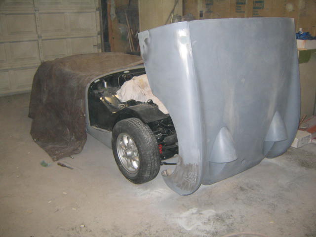

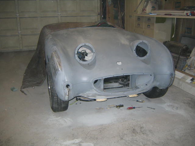

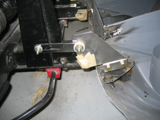

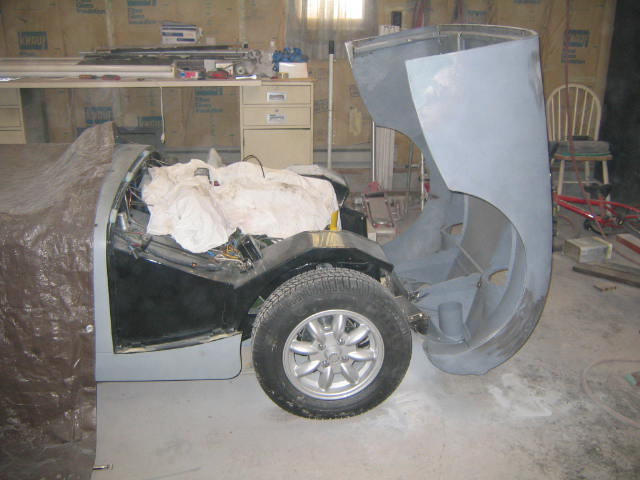

Still have some adjusting to do, but....

nice - nice bracket
A sway bar, if you don't have one is a very nice addition.
Don't know what it is like without one on there. Feels nice the way it is though....
Speaking of which, I wish I could find a vendor with Poly motor mounts!
Nice looking fabrication! My Jag bonnet mounts in a similar fashion, but I'm years away...
Oh boy, and she is smileing. Look at her.
A little blush and some eyeliner and she'll be good to go.

Kim, I don't think anyone is trying to copy a 'Vette. It's because a forward tilt bonnet makes it <u><span style='font-size: 12pt'><span style="color: #FF0000">really</span></span></u> easy to work on. You must have never bumped your head working in the "bears mouth" of the original setup! /bcforum/images/%%GRAEMLIN_URL%%/grin.gif
Jeff
Done that. /bcforum/images/%%GRAEMLIN_URL%%/smile.gif
I am keeping the original hinge method, though. Part of the charm. Maybe I'll just invest in a padded helmet... /bcforum/images/%%GRAEMLIN_URL%%/grin.gif
With the tilt forward bonnet you don't have to bend over to work in side. In addition everything is much easer to get to.
