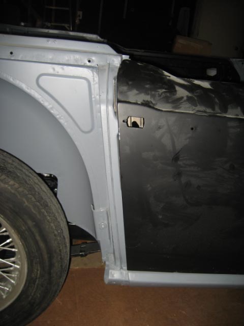

OK, got the body back on the frame so I can do the trial fit of the panels. Everything is lining up pretty well except for the rear right fender. What's the method for closing this gap? Already got two aluminum spacers under the rear of the car on this side...

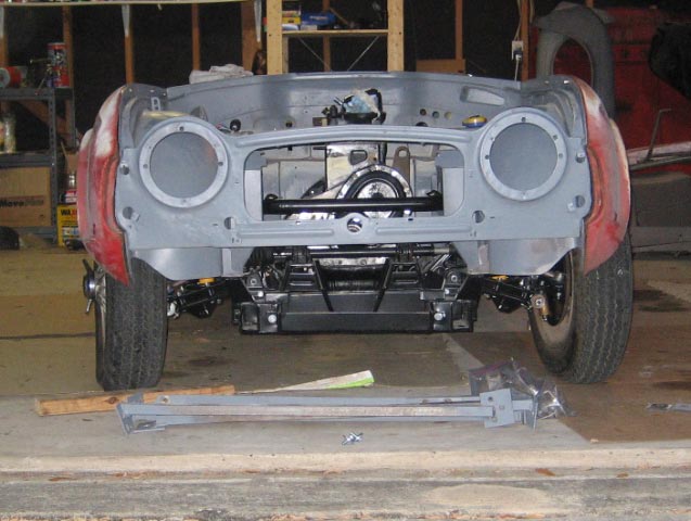

Also, is it me, or does the front valance look like it's not straight..?
Thanks for your help.
Myles

From what I can see I think that it's you not the valence. Do that to myself all the time.
Tinkerman
Myles-
Looking good. Can't tell on the valence, but you probably can check by some careful measures relative to the frame. Your passenger side looks a tad high perhaps? I would measure both valence and frame height as with your new suspension things may not be level in general.
I think I spot my old bonnet in the back there - if you aren't using it I may be a potential buyer again as I've been pulling apart the project TR4 and it doesn't look too bad yet!
Randy
rlandrum said:
TR6BILL said:
How ya gonna line them up without the fender in place?
I'm glad I wasn't the only one thinking that.
Maybe he meant the gap on the bottom?
Maybe the fender is fitted and is out of shot to the left and it's that very large gap that he,s worried about!!
It does look like it's high on the driver side. I drew some straight lines on Paint and it does look like it's few inches high. The front of the frame looks straight but the shell looks a lttle crooked. Here's the pic with the lines I drew. Maybe it's just the way the pic was taken.
Excellent illustration on the picture, but I still say thats the passenger side - I think Myles is still converting this one to right hand drive!
Myles - if you find you need to reposition the valence, you are welcome to test out my Hobart Mig setup I just picked up to attempt floorpan work. I have no idea what I'm doing with it yet though.
Randy
