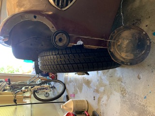

Just rebuilt front suspension on my bn4 along with a disc brake upgrade. Had kingpins rebuilt all poy bushings.
Camber seems to be really off.
Using your photo and my iPhone that looks like about +10 deg camber; stock is +1 deg. Have you got, or did you have an offset upper bushing? Was the car in an accident?
You have to move it back and forth to settle the wheels into the correct camber. They'll be cocked if you just lower it off the stands without pushing it a ways till the wheels even out.
Look at the tire relative to the ground, not the vehicle body. I'm guessing that the camber is about +10 degrees.
