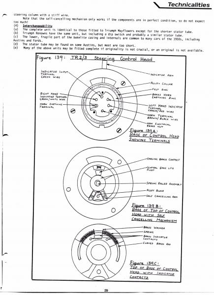

My turn signal self canceling is sporadic at best.
i was planning on working on it this winter.
but having read Randall's notes ( borrowed from his photo-bucket post )
at the top of the attached page, I'm wondering if it's worth trying to fix.
Or, Are there even new parts available & what would I need?
other than that, (really only the left turn cancellation is sporadic) the control head is doing it's job.
but I am known to drive around, miss-signaling, for extended periods.
The entire head is available new (last time I checked), but I've never heard of anyone selling new parts.
I should point out that I did not write the article above, it was written by Richard Larter and originally appeared in issue 62 of TR Action (Summer 1985). There is a slightly more legible (and complete) version available at
https://drive.google.com/open?id=0B2H2NJt34OffRVBPNlp1NkVMcFE
