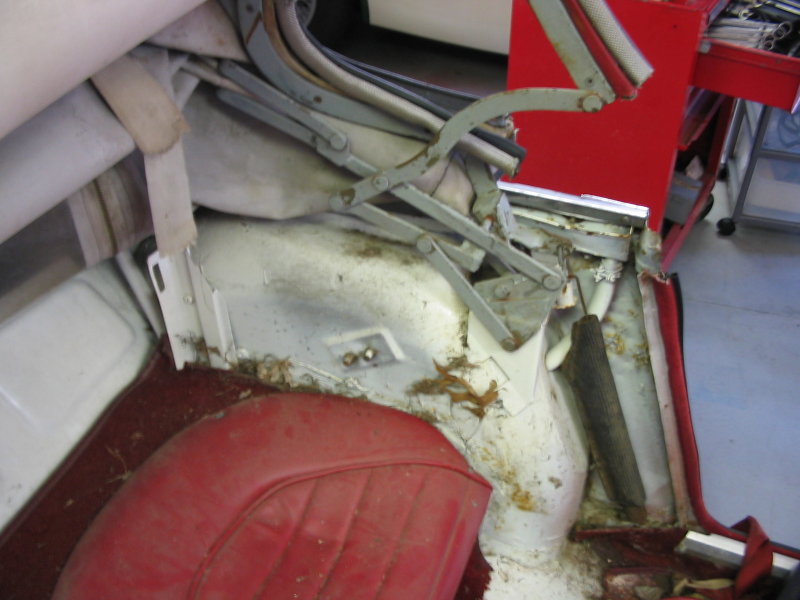

Take the springs to a good old fashioned hardware store and they'll find a replacement for half the cost. Make sure they measure the tension correctly. Not sure if the manual tells you the proper tension or not. I was able to secure the springs on the bottom first then lever up to the top with a notched bar. If I recall it wasn't that difficult, but I did have the interior out of the car. Might be easier to pull out the side panels first. Don't think it's original but the previous owner used an "S" hook to aid in installation.
