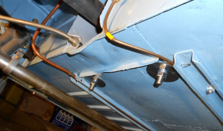

The VW Bug column might actually be a cleaner swap because of the way the lower portion of the collapsing column is restrained. It wouldn't need that large box structure added, just a bit of local reinforcement.
While this dies not appear to be that daunting of a project, I think additional cogitation is in order. Far easier to fabricate the mounting box and reuse a s
Spridget column that mates properly with the steering rack. He does not address how that got done. Or maybe it automagically connects to the rack.
