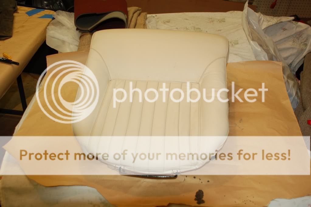

Re the replacement seats vs rebuilding the originals. I am rebuilding mine, and once you get them apart you see how especially in the spitfire it is so hard to get anything else to fit. The amount the seat bottom and the upright frame are built so they hang over the center tunnel is pretty obvious once you get them apart. I started with just the frames and everything else is new.
Any way....
I'll attemmpt to attach a pic of my first attempt at upholstery. I purchased the foams from Rimmer Bros UK, and doubled the price getting them here. :cryin:
I did the upholstery because I couldn't find anything in the color I wanted, and in leather to boot. Plus as in a lot of things I do in life... How hard could this be? :rolleyes:
