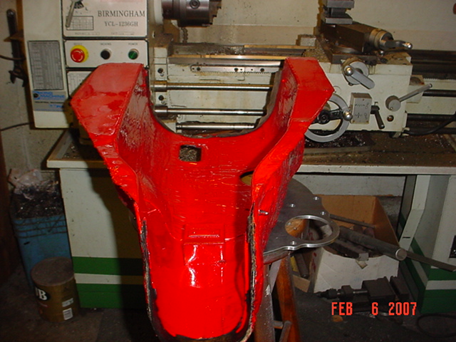

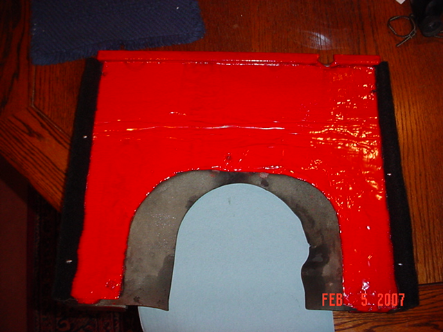

Yes, two layers of Dynamat on each side, all vertical & horizontal surfaces. All overpainted body color. The paint helps seal any gaps in the Dyna joints to keep water out & gives a uniform appearance to the floors.
The closed cell foam was only loosely laid under the horizontal floor surfaces of the carpet which are removable & retained with snaps. It just gives a bit of cusion feel to the floors. No foam under the spacers, seat areas, & vertical surfaces.
The engine compartment has all surfaces over painted, no white asbestos board showing. I've read that some original cars also had the asbestos over painted so I don't feel too bad about the departure from originality. I've noticed that the original white gets pretty dingy after a few years of use. To paint or not would be your choice.
Couple of pics attached.
