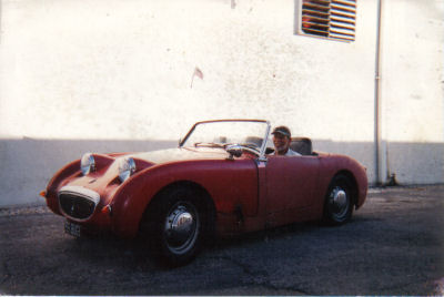

I have a set of early, high back Corvette seats in my BE, only because they were "gimme's" and the original seats were pretty far gone (still have them to redo though 'cause I do like the originals)...another non-original alternative that would fit well IMHO would be a set out of a 914 Porsche! Here's how the 'Vette seats look sticking up out of a BE
