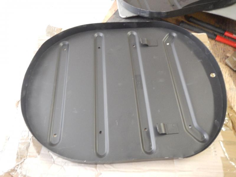

Are they selling the pivoting bottom again? They were at their last one and needed it as a template...

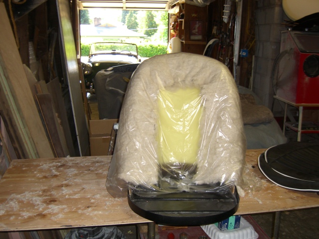

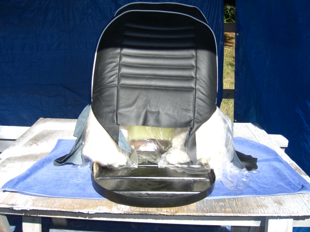

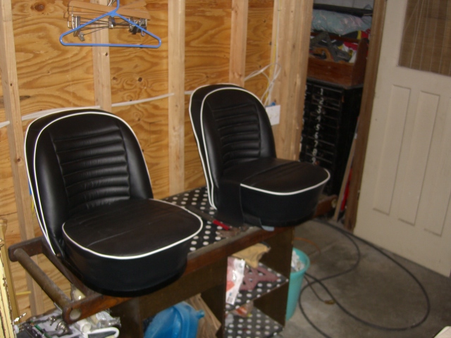

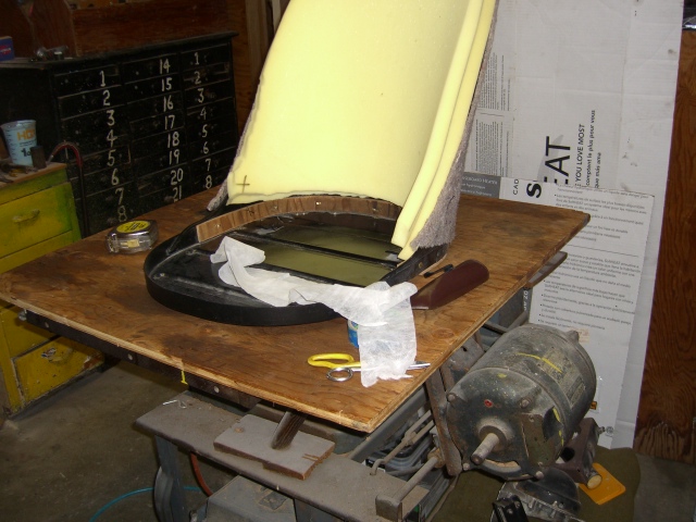

Anyways I bet somebody is looking for some bug-eyed seats, so you should be able to maybe break even there. I just finished my seats and made my own form kits with cotton batting and foam and it was not difficult. I will post them but first I need to delete my old pics form room. The hardest part is cleaning up the frames and repainting them once you find some.
Sorry about the formatting. The forum changed my post because I ran out of room and had some pictures to post also. My computer freaked out.
Here is a general way how I rebuild the seats. There is moreto it but not that difficult.

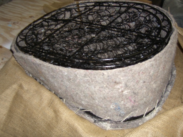

Yeh I think so too, plus I think the factory was trying to that. The first time I rebuilt a set I went will horse hair and burlap and actually duplicated what the original ones had. This time I went with 2 inches of foam in the front to get that modern fluffy look that I see on the tr3s today. They are almost too fluffy and have a lot of give. Your sets are what they looked like.
I went with the original type springs this time too because there was a new one that come with the car from 1978! and they were a pain getting into the bag. The springs are too tall and walk side to side, plus I think they will cut right through the burlap with natural movement, so I liberated one of your ideas (the stitching part) and stitched 1/4 composite padding around the springs in 2 pieces because I could not get it to fold over and around; I hope it holds.
