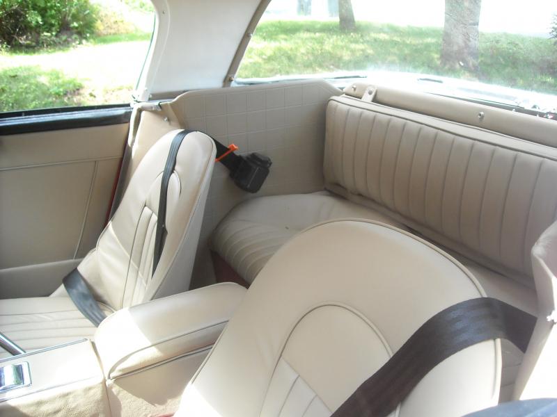

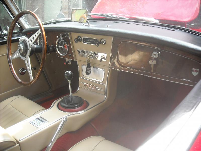

I would most definitely agree with Marvin on this. John Skinner in the UK provided me with a complete front & rear BJ8 leather seat kit, including their in-house front seat and back rest foams & door panel kits. Excellent craftsmanship on ALL their products. All were true to originals as per on my car. Front seat foams were a perfect fit, and no trimming was required. I did the job myself, using my old seat foams & covers as templates & guidelines for installation of the new foams & covers & door side panels. AND they provided me with the correct red Karvel carpeting to boot.
I've included a few pics to illustrate.
ROBERT
