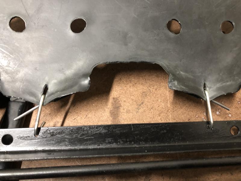

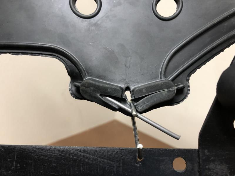

I rebuilt the driver's seat about 4 yrs ago with foam/parts from Moss. The project's been idle until the last two months but I don't remember any problems with the first seat. I installed the seat diaphragm on the 2nd seat. All clips installed successfully but I went out this morning and there was a failure on 3 of the locations that pulled the small rod through the rubber. The garage and parts were not cold (Don't judge... I live in Texas and the garage was about 68F.) I ordered a single replacement diaphragm but after searching the forums and not finding any with this specific failure, I'm wondering if this is an installation issue (it's me, not you...) or a defective diaphragm. Any thoughts?

It's been a long time since I replaced the diaphragms on my TR6. I can't say that you've done anything wrong looking at the pics.

I had a pair of these fail in the same way after a few months. Dont remember where i got them, but there are some bad ones out there.
Not that this is necessarily what you did, but the last diaphragm I tore was from kneeling on the seat while trying to fix something. I felt a pop and sure enough, 3 of the clips had torn completely off.
It's possible, with a little extra grunt, to install doubled diaphragms if you want a little extra security (and possibly a little higher sitting position).
I had the problem too, I don't remember where I got them, but drivers side failed a few years after redoing my TR250, I redid the seat properly with new seat foams (I had just recovered before) and has held up fine, I am not huge but not time at about 215 these days, sure that doesn't help. I think the new foams probably help spread the load better.
It is most likely not you but it does not have to be pulled tight the foam does the work and the rubber keeps you off the carpet so use longer clips. Madflyer
I kneeled on my seat with a TRF diaphragm and it parted at the metal tabs as described in an earlier post; their part was very thin around the edges. The Moss replacement was much beefier and should last longer, but even with new foam a misplaced knee may wreck them.
