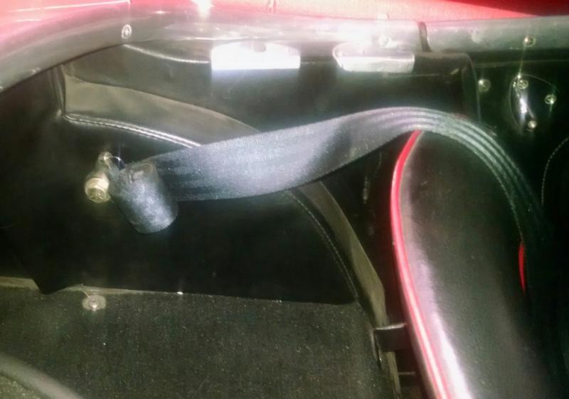

Yes, the installation shown in this picture is one that seem very questionable to me. Envision the seat belt as two segments of a line as it passes over the shoulder with the shoulder as the apex of an angle: As this angle gets further from 180 degrees and closer to 90 degrees it seems to me that one's/shoulder torso can easily move forward. The setup requirements for HANS systems recommend that the anchor for one's shoulder harness be at or above the plane of the shoulder for the same reason.

In the picture, the bolt is as high as I could get it before the fender well curves outward.

I think we all know that our cars are inherently unsafe with a steering column that wants to impale us and doors that offer no side protection, etc. Nevertheless we are talking about making our driving a bit safer experience and unquestionably simple lap belts (that is what I have and I would like more) leave a lot to be desired. But a three point set up with a shoulder belt that isn't set up properly to restrain one's torso, etc. etc. provides no more safety than the lap belts and there might be a risk of injury to one's neck by a diagonal belt that winds up in contact with one's neck.
Again, I'm not eschewing three-point belts--I simply suspect that the 3rd point of attachment must be higher than the one you picture. I am not inclined towards the ultimate of a five-point system with proper shoulder straps and an anti-submarine belt as I have in the race cars but I would certainly be interested in a setup for a street Healey where the anchor for the shoulder strap is as high or higher than my shoulder. I don't think that would require a roll bar but it would probably involve the addition of something that would provide a strong and properly located anchoring point.

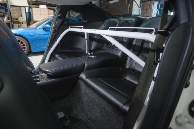

The setup pictured is probably used with a conventional pair of shoulder harnesses with the straps wrapped around the bar. For a three point system I think one could get by with something a bit less obtrusive, but yes that would certainly serve.
