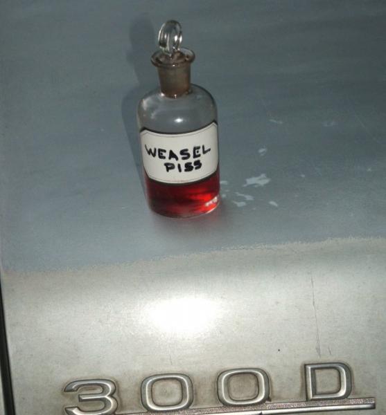

Mickey x2. Once you pull the seats, remove the seat back and pull the cover, it will be pretty obvious what needs soaking. I used PB Blaster on my first seat and it took awhile for the smell to go away so I used weasel pi$$ (50/50 acetone/atf) on the second seat. Works faster and smells better. Spray everything rusted and start working that handle!

See what you started Doc! Weasel "P"! Do you get any royalties from the manufacturing of this fairly new product? :highly_amused: Should have patented it! I think their even using it across the pond! PJ
