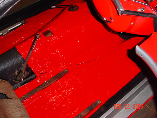

The second place I used it was to remove the inside carpet padding which had been glued to the floors & transmission tunnel. The padding was removed, underlying surface wiped down, & two layers of Dynamat Xtreme fitted & tightly rolled dow over the cleaned inside floor surfaces. The very sticky Butyl rubber backing of the Dynamat assures that no moisture will get betweent it & the metal to cause future rust. The top aluminum surface of the Dynamat was painted proper body color. A loosely layed section of 1/4" thick closed cell foam was placed under the carpets for easily removal. The carpet & foam was secured with a few invisible carpet snaps. Makes for a much cooler interior. See the attached pic.
