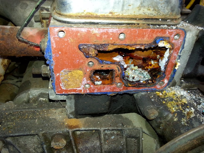

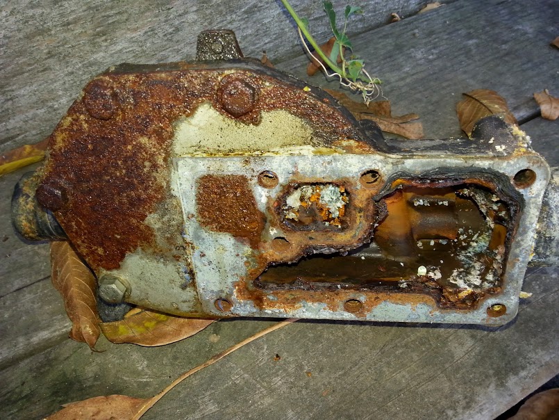

I've just received a '70 Europa S2, which has been sitting since 1980.
Removed the water pump, as all the hoses to it were in a sorry state. Lots of corrosion.
I think that NAPA have new pumps for around $75 : https://www.napaonline.com/Catalog/CatalogItemDetail.aspx/Water-Pump-Remfd/_/R-WP_571162_0267424297
But does the old pump look beyond salvage?
What should I do about the corrosion/deposits in the head?

Hi Julian!! Glutton fer punishment?!? :smirk:
About all you can do with the engine in the car is flush it out with a garden hose until the "red" disappears from what drains out. Separate the radiator from engine at both in and outlets, flush each one.
Mechanically remove as much of that goo in the head as you can before running water thru it.
Otherwise, "boiling" the block after an engine tear-down is the method used by machine shops.
...and FWIW, just replace the pump.

If you want to keep the same pump there are people on the "Worst" coast that rebuild them

Just placed a biggish order with Dent ... new water pump, new hoses, other bits and pieces.
I ordered a new one. Although I haven't taken it apart, I expect the old one is too far gone - there's quite a bit of rust evident, although the impeller does still turn.
