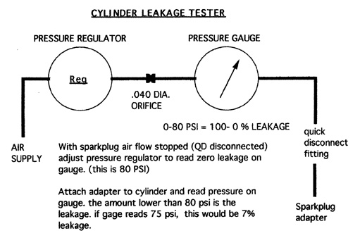

Hi JC,
I'm not sure that you present leak tester will tell you much. You need a pressure regulated air supply, a gage, & most important a .040" restrictor. Possibly .030" on smaller engines & .050 on larger engines. With an endless supply of air, no restrictor, there is no way to tell how much actual leakage there is. Small pressure regulators & quick disconnect couplers are fairly cheap & will give you meaningful readings.
I have attached a sketch of a simple but quite accurate tester that you can make. The restrictor can be one of the fittings that is soldered closed & a .040" hole drilled through the solder.
D
Edited - a couple of examples:
A good well built race engine will have 3% leakage or less.
A good street engine will have about 5 to 8 % depending on amount of wear.
An engine can still run pretty well with 12 % leakage, but power will be noticeably down, & starting will be harder.
D

That sketch definitely does belong there. I was going to ask but looks like Basil beat me to it. Oh and Mark, its 3074 now...lol but I didn't miss the reference...
JC
