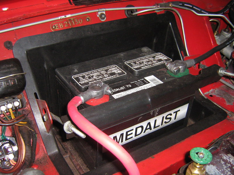

My base looked about like yours. I ended up installing the Moss plastic battery box. Here is a photo of what it looks like. I like the look of it myself, but I guess that is just my own preference.

On my TR there is no drain hole visible at the bottom of the box. There is no drain hose under the box. I'm guessing the "linoleum liner" covers the drain.
Where is that hole supposed to be? Where is the drain hose supposed to run - behind the heater and out through the passenger floor well? Does anyone have a picture of all this?
RedTR3 - the Moss box looks interesting. Does it have a drain hole?

The plastic drop-in from Moss (et al) does not have provision for the drain. But since it's plastic unaffected by battery acid, the drain isn't really needed.
