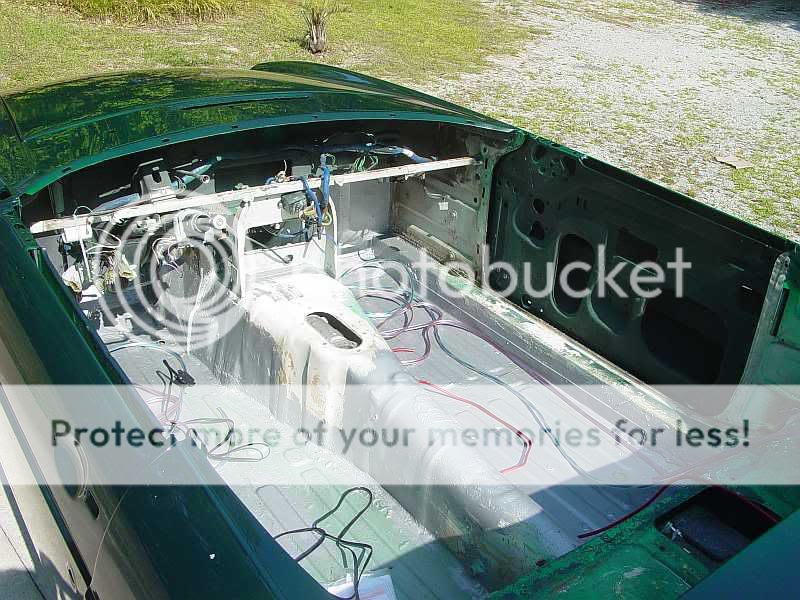

here is a shot of rustbullet on the floors, where it was brushed on.
