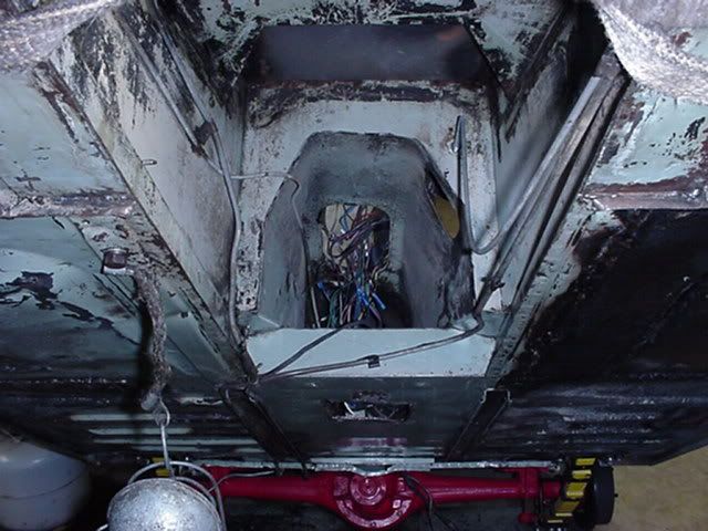

I'll post another picture here in a moment, (definitely not surface rust). This is deep rust we are talking about.
A sand blaster of some kind seems in my mind to be the best idea, less actual contact between the operator and the patient should equal less operator fatigue and therefore a better and faster outcome. If it will manage to penetrate deeply enough.
Here's a good example. Linking it because it's a big one (2080 x 1544 pixels):
example of my rusty areas
That's the floor area on the drivers side (left). The passengers side is very much like this. These are pretty much the worst areas on the car (that I have found).

You have "thorugh rust" on the floor panel. Take a pointed hammer (not a ball or carpenters hammer) and bang the rust. Hit medium hard. If it goes through (which it will on the floor, and not on the chassis member, and maybe on the strengthener), then you have to put in new metal plate.
Sand blast the parts where there is surface rust and the hammer didn't go through. Cut the through rust out with metal cutters. Buy some metal plate, 1 mm or 20 gage. Form the metal with a hammer and dolly. Weld it in around the edges. The nicer you form the piece, the nicer the repair will be. Overlap the original panel with the new metal about a cm or less. Do nice welds and maybe you will not have to grind them down smooth.
Zink primer, top paint and rust protection afterwards.

I'm kind of fence jumping today. I'm involved in a frame off restoration on a TR3A. I have both a bead blaster and a pressure sand blaster. They definatly save time, I can tell you from experience that a wire wheel on a drill won't cut it, so to speak. However you need to understand that you need a big compressor(60 gallon) air reserve, putting out 15 to 16 CFM AND you need to do it outside. With all of that said from what I see of your rust pictures I really feel that unless you start taking things apart you will be getting rid of less rust than you might find that you actually have.
