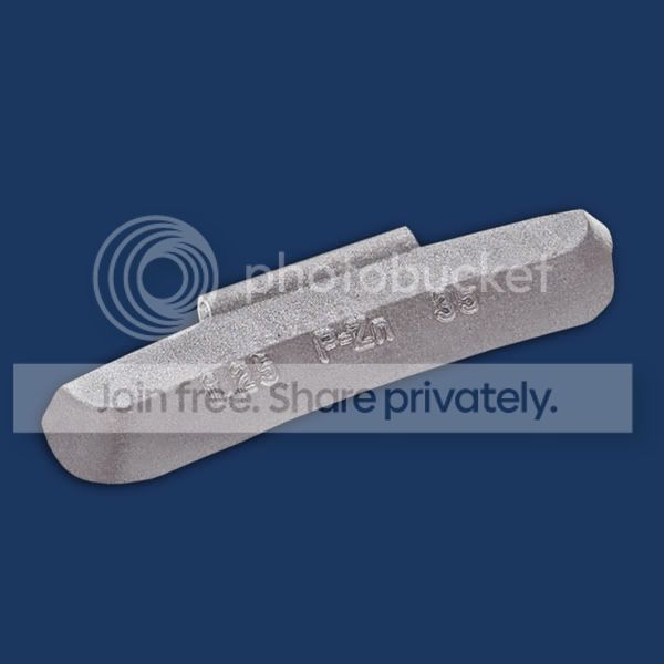

Okay; you guys who know metal, and its many quirky properties, chime in on this one. The newest wheel weights are made of zinc, and zinc by contact will "sacrifice" to protect an adjoining metal.
Why can't we (old car owners) attach these to flanges all over the car body and frame to prevent the advance of rust?

There have been rust and corrosion prevention systems marketed for cars for donkey's years, and they work about as well as snake oil.
Attaching zinc anodes to the steel sheet metal or chassis "all over the car" , in the presence of moisture, any moisture, will cause electrolytic corrosion at each junction (steel/zinc). So, rust and corrosion will increase not decrease.
Now, if you wanted to bury your car or float it in water, sacrificial anodes might help. But under normal operating conditions your tires provide enough insulation to prevent significant current flow from car to the earth. :jester:

For the zinc to work, you have to be operating in a medium which conducts current. Air will not, and fresh water is a poor conductor. If you do a lot of salt water boating with your car, though, it will work great!
Any powered device has the same restriction...you have to complete the circuit through a conductive medium.
