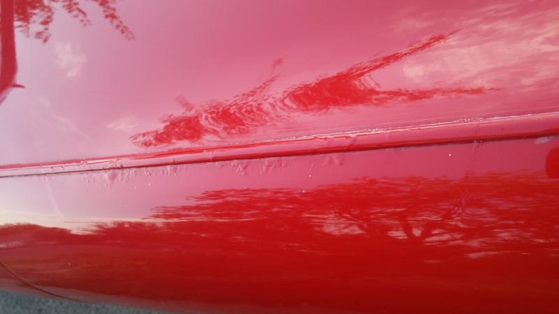

I've been wanting to do something about a bubbling issue on the seam on the bonnet since I got my car, most likely will attack it this fall. So perhaps someone can give me some direction. The paint on the bonnet is a good 5 footer, so I don't want to repaint the entire thing, rather just deal with the issue and spot it.

This is one of those issues that always have tons of different viewpoints. I have the same problem on my Spitfire. Until I can get a full paint job, I use
a Dremel with sanding drums and disks. I use the tool to get below the rust and then feather the surrounding paint with 600 grit . Because it's a temp job I use a
spray can of primer and then the nearest match spray can of color. Not perfect but less noticeable at 5 feet. Treated several bad spots last year and so far they are holding
up.
Just remember that those bubbles also are bubbling in the other direction, too.
I was reading up on dipping for rust and stripping, didn't see too many good reviews on it due to chemicals not getting cleaned out completely. Seems with the beading it would be about impossible to deal with without dipping however
I had my bugeye dipped at a Redi Strip location about 30 years ago. It was stripped of the rear fenders but not the front. Got into all the crevices of the beading and I've never had a problem with chemicals dripping. (Did eat up the body tags, though). Only other way I can see of dealing with the beading rust is what some guys have done. Cut it off, dremel out what you can of the remaineder between the fender and shroud, then kill the rust with your favorite treatment, epoxy prime and braze or glue on replacement beading.
For temporary I think I would go with spot sandblasting. Sandblasting gets into the rust pits better than about anything. Then a little glazing and/or filler and paint touch up.
